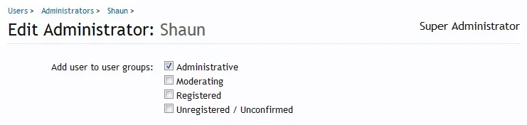

Okay, tried and tested, and still getting the permission problem:
User account - Shaun - Is a Super Admin and only belongs to the Administrative user group. So changes to other user groups should not impact on Shaun's ability to post etc.

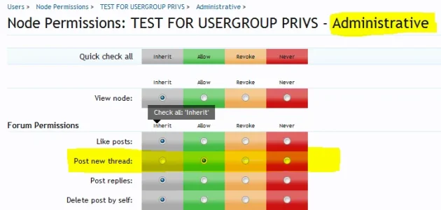

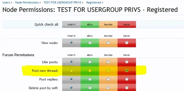

So, we change the node permissions for this test forum and we say that the Registered user group can Never post - that's what we want - want to remove their ability to post and never want them to be able to.
Admin should still be able to post in the test forum - right?
Just to ensure Admin user Shaun can post, we Allow the Administrative group to post - we explicitly give permission.

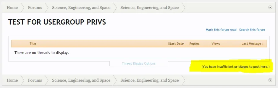

So, when user Shaun from the Administrative group (who isn't in any other user group) tries to post in the test forum:
... he's DENIED!!! lol
So is this a bug? or am I misunderstanding the permission system?

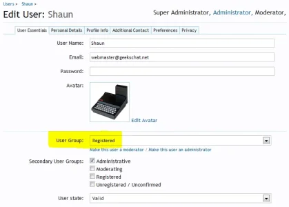

  • #11
Can you do a screenshot for Shaun from the standard users screen?
The one above is the Administrators screen.
Do you mean the user profile screen - when you click on the username in the front-end?

  • #17
You da man Pauly ... you da man!!!
Seriously, though, thanks ... it was confusing the hell out of me and I never thought to look at whether the "Admin" account would actually just be a regular registered member.

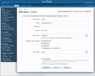

  • #18
This is actually the correct way to do it.
All members should be in the Registered user group as their Primary.
Any additional user groups should be Secondary.
Just use Not Set (No) or Revoke instead of Never and it will work fine.
It is recommended however that all users have the Registered user group set as their primary user group and any additional groups they are members of are set as secondary groups. This makes it easy to manage permissions due to the cumulative nature in which they are applied.
