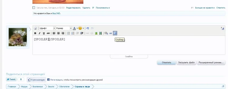

I've added button for custom BB code by copying and modifying code from "quote" button. There are three files must be modified for this task:
editor_template.js ( TinyMCE theme definition )
editor_js_setup
editor_ui.css
and adding new phrase to used languages
I have not any web programming experience, so it's maybe a creepy way, but at least, it works :D
editor_js_setup
editor_ui.css
Can you share code? Thank you.
Nek
This pack contains three txt files which shows code changes. You can find them by arrows at left side.
BTW, editor_template.js changes were applied to a copy of original theme placed in another directory in "js\tinymce\themes\". And this files shows theme changing code too.
