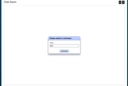

I've just installed this on our main site and we're ready to go live but for some reason it's not working.
On my test site I have:

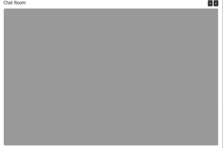

but on my live site I have:
This is using the "LightIRC (lightIRC Flash)" option and I don't have a clue why it's happening.
I've reuploaded the files and reinstalled the addon but with no success.
The only difference between the two is that the working one is version 1.0.7 and the broken one is 1.0.8.
RobParker
Uninstalling 1.0.8 and installing 1.0.7 does't fix the issue.
Also the "popup" window works fine, which is really confusing as it suggests all the settings, javascript, etc are ok.
Edit: the popup window doesn't work fine. I at least get the login box for lightirc but it won't connect to the server (ustream.geekshed.net)
My error logs show:
XenForo_Exception: Invalid model 'EWRhabla_Model_Chat' specified - library/XenForo/Model.php:192
