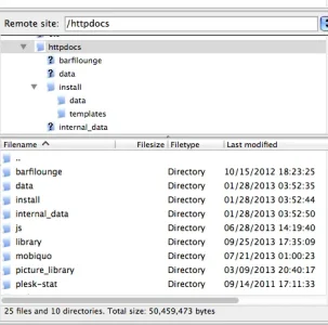

ineedhelp
All the files were overwritten fine. As I have done with previous upgrades. I can even see the 'Last modified' dates for the files uploaded have changed to, todays date.

There's only so many ways it can go wrong...
Open the file library/XenForo/Application.php
What version is there?
Also, upload a screenshot of your FTP program where the files are uploaded to.

Looking at the board listed in your customer account, I get the "board is being upgraded" message and going to the install URL shows 1.2.2.
ineedhelp
@Mike was right, the issue was to do with APC - The hosting co. has corrected this and now the upgrade is in progress.
