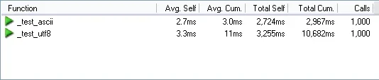

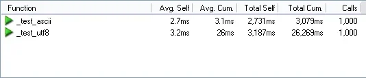

Definitely slower. I had wrongly assumed that those utf8 helper functions didn't utilize any mbstring functions. I just did a quick profiling and it turns out utf8_strtolower is almost 3 times slower when there are no mbstring functions available to it.utf8_strtolower (without the mb version)
