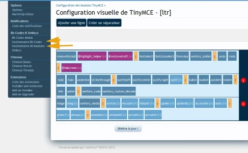

There is a Bb Code manager where you create and edit your Bb Code and can configure its button. Then there's a button manager where you can position the button inside the editor. Did you do that?
It show up but for some reason the rest of the buttons are broken??
PM sent mate thanks!
Your buttons are not broken. You didn't specify a valid button image. Please read again how to upload an image on the server.
1) upload the images in the directory {yourforum}/styles/KingK/editor/
2) the image name must be the tag name

  • If the Bb Code has a button (with this version this version, the spoiler & highlighter Bb Codes have one) , you go again to the Home page of the administration, you click on "Buttons Manager", you choose which editor configuration you want to edit, then you can change buttons position inside the editor.

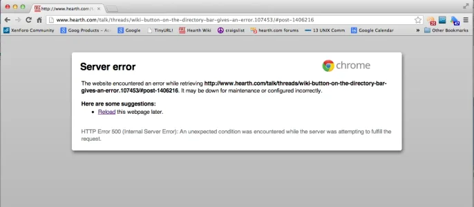

Ok, here is the error...
none in the XF panel
A full server error in the browser when I try to go to any forum that is not public!
I turned it off again.

Opps - all the moderators just reported errors also.....
That's not a very much informative error. I would need to do more tests to find this error. I've just registered to your website. I would need a temporary admin perms to get access to the XenForo options and Custom Bb Codes permissions. I would also certainly need a temporary ftp account. Once done, give me 15 minutes to try to locate the error.
wow, thanks for the offer. I'm away traveling (vacation) so I am not going to attempt this until I get home.
I'll install the same stuff on my new forum (no traffic there and less add-ons) and see what happens.
Strange that it didn't throw off any ACP errors. But now I have lots of reports...all users at that moment had errors.

Ok. For the record I can access this thread without any bug. If you have time, you can also try to disable some addons one by one to check if they might be a conflict here. I don't see any reason for this to happen, but it often helps a lot to debug.
Two others questions : did you try the former 1.3.4 version? Do you have also this bug with it? I'm asking this because I've used some php SPL functions in the last version. They should be compatible with php 5. Which makes me ask you the second question: what is your PHP version?
Everything works on the site since I disabled it a couple seconds after the errors...
I didn't try the old version.....maybe I will do so once I return home just to confirm...
PHP is 5.2.10
That thread had nothing to do with your errors - that was a wiki tab which I removed from the menu (we are testing xencarta)
