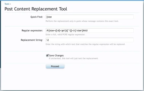

For the size tags use this to simply remove the tag:
Quick Find: [size
Regular expression: #\[size=([\d]+)pt\]([^\[]+)\[/size\]#siU
Replacement String: \2

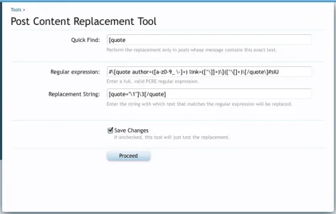

For the quote tags use this:
Quick Find: [quote
Regular expression: #\[quote author=([a-z0-9_ \-]+) link=([^\]]+)\]([^\[]+)\[/quote\]#siU
Replacement String: [quote="\1"]\3[/quote]
