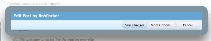

Erm not sure what's happened but I seem to have bugged out with the above post. My paragraph breaks got removed for some reason but when I got to edit it I don't get an edit box... Screen shot 2011-03-09 at 18.04.06.webp
I can click on more options and edit the post but it doesn't show up in the inline editor...
I get that on my system also every now and then .. I simply reload the chat window and everything appears to start up as expected.

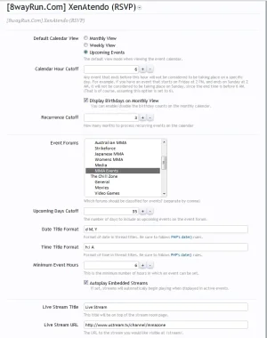

Ive been trying to figure it out myself but no luck. I cant see to get the 'show stream' button to show. I have the latest medio, events, porta and habla versions. This is also on a local windows server as I wanted to test this feature out before I deploy on production. The chat works, everything else works as per normal. All settings are basically default but all is working as it should. I thought it may be permissions but there is no permissions for XenHabla as far as I can tell, what am I doing wrong? thanks mate
try going to http://yourdomain.com/stream/ to verify that you have everything set up correctly. If it does not work its is usually because you have incorrct URL for the channel you are trying to broadcast.
This is the Livestream URL configured in XenAtendo
Hi Masterchief, thanks.
/stream gives a 404 and re-directs back to the forums. I havent actually changed the setting in XenAtendo thinking the default string would at least show something?
ATM livestream URL setting points to ;
http://a:4:{s:12:"event_stream";s:37:"www.ustream.tv/channel/8wayrun";s:10:"service_id";i:1;s:13:"service_value";s:7:"8wayrun";s:14:"service_value2";i:1121923;}
Which is the default, should this work just how it is? even if it is 8wayruns channel? Thanks
Damn, that was easy. I didnt want to edit it because it looked complicated and necessary lol, thanks Jaxel
Yeah, as it turns out, when you install a mod, it runs the verifyOption routine on all your default values. So because of it, it warped my default value. I thought the default value had to be the final outcome, but as it turns out, it only had to be the initial setting. I fixed it for the next release.

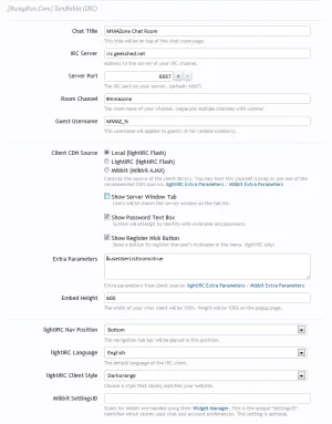

I cant figure this out. I can get my stream working perfectly on local/dev, shows a little image when offline like your site and streams work both from mobile and PC. On my actual website though its a different story. Basically like a blank screen
But you can see for yourself @ http://mmazone.com.au/community/stream/ or even clicking the chat. Settings are 100% identical to my dev which works fine... any ideas what could be wrong? Im stumped, thanks
XenAtendo Settings
XenHabla Settings
